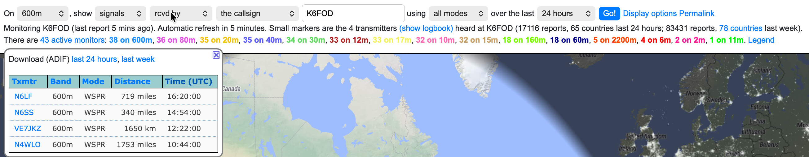

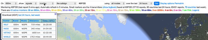

I’ve also had a look at pskreporter.info:
I only see WSPR spots there, but again, perhaps the last FST4 spot was more than 24 hours ago. If you see your spot on pskreporter.info, please post a screenshot and I’ll check the logs again.

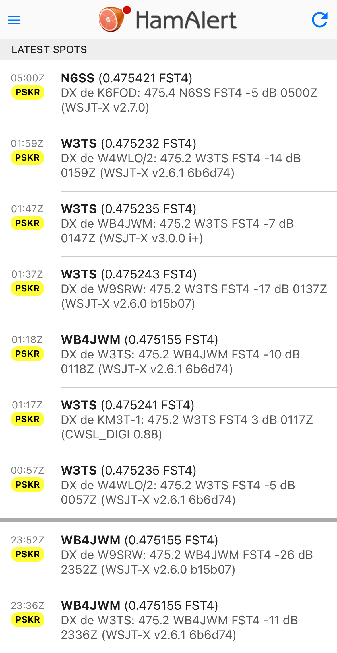

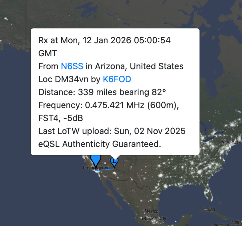

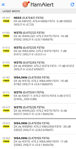

Here’s an FST4 spot on 600m that my skimmer sent to PSK Reporter tonight. Interestingly, I also received a HamAlert notice for the first time. Did you modify anything?
No, I haven’t changed anything on the servers as I could not find anything wrong with the code/configuration. I created a trigger for 600m FST4 in my account yesterday to make sure that spots like those that I saw in the log actually triggered an alert, which they did.
Ok, thanks. It’s unclear to me what might have accounted for the apparent issue before, but it seems to be functioning well now. If any further questions come up, I’ll let you know. Thanks for taking the time to look into this.
