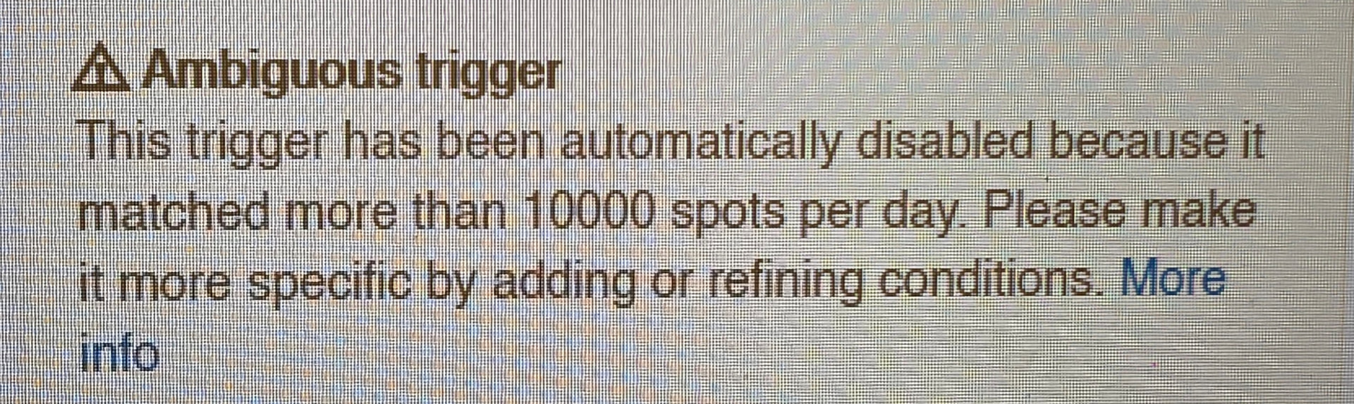

Unfortunately it does not work. Soon gives Ambiguous trigger and it’s disabled.

You need to add this condition to your existing trigger(s), possibly all of them if they also match 40m CW. If you create a separate trigger with only a “not Callsign” condition, what you’re effectively telling HamAlert is that you want all spots (i.e. around 40 million per day), except those for the listed callsigns.
