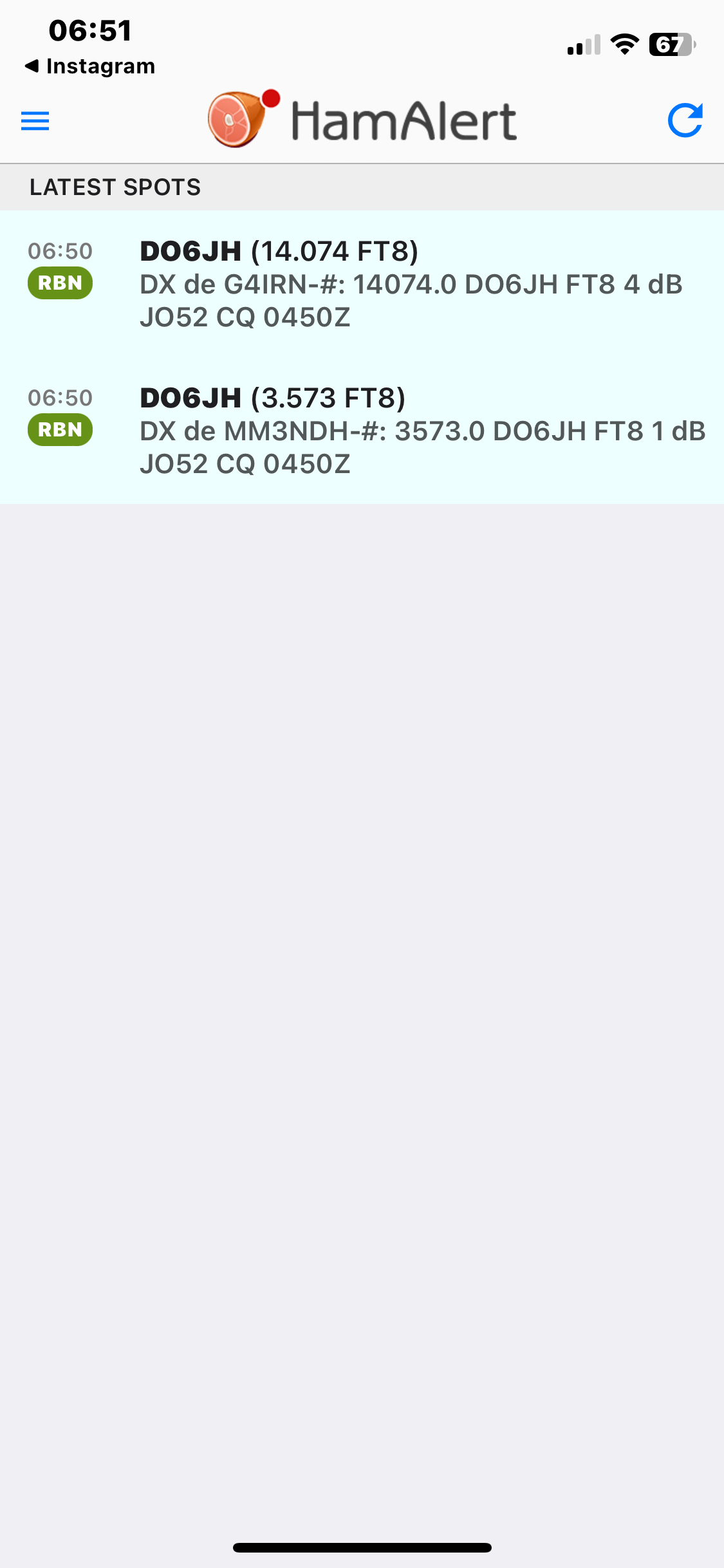

If I or others are on 80m… there is also a false 20m alert .
All false alerts via G4IRN
I have now enabled the same “quorum” logic for FT8 spots from the RBN as for those from PSK Reporter. Specifically, at least three spotters must agree on a frequency/band for a given station before the spot is processed.
