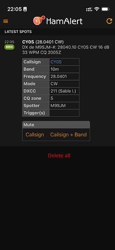

Is there a a way to have fixed frequencies (identified frequencies as CW) as an option to automatically identifies as Cw and not FT8. Now I get a massive amount of CW alerts when actually they are on FT8.
I configure my trigger for Mode: CW, and sources RBN, Cluster, and PSK Reporter and I don’t seem to see any reports for FT items. 73, John/N8FYL
Thanks. I did not have the sources added. I hope this will do it.

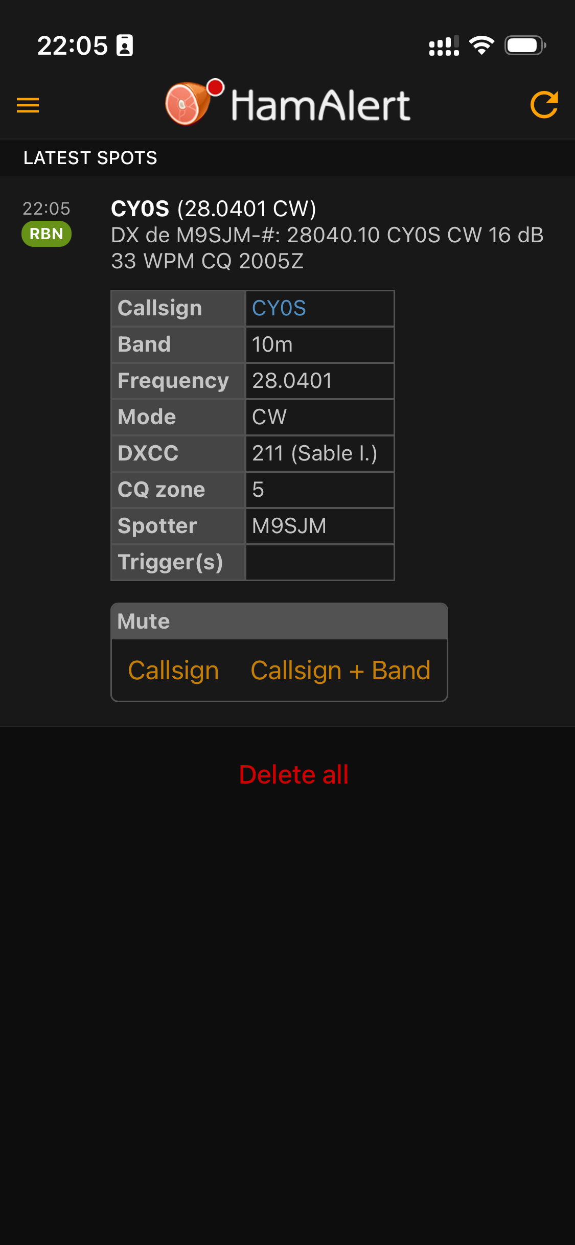

Still this spot.
That spot came from the RBN and was marked as CW, so from HamAlert’s point of view, it was correct to send an alert. Could it have been a pirate on 28.040 CW perhaps?
If you want to avoid this particular case, I’d recommend that you remove RBN from your “Source” condition.
Hi! Ok I see. I got perhaps 20 pcs like that. I will try. It is quite common they send Ft8 spots as CW from RBN. Happy Easter!
