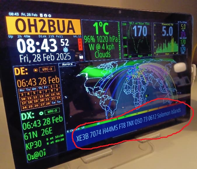

HamClock displays an RSS feed line-by-line at the bottom of screen. The feed is (must be) very simple by data content. (I can provide a sample.)
What a great place to observe spots in one’s living room, I think.
HamClock does not natively show spots. In the picture there’s just my dirty hack which grabs (and filters) spots from dxsummit. I’m using a dedicated 10" tab as a display.
