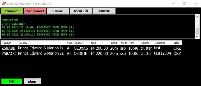

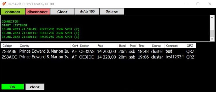

Ernst OE3IDE has just published his “HamAlert Cluster Client” for Windows that can connect to the Telnet interface of HamAlert and show Windows taskbar notifications on new spots. Check it out here:
