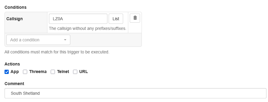

There are several ways you could do this but the simplest is just choose callsign and then enter LZ0A.
Gordy N4LR

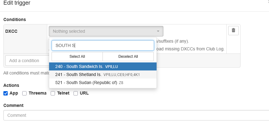

if you want it not just for the current dxpedition you can use DXCC.

Hello and thank you for the reply. Sorry for the confusion, I meant the Shetland Islands, located north of Scotland in Europe.
For WAE and DX Marathon, GM/S (Shetland Islands) counts as a separate entity, but there is no prefix that is unique to Shetland. Any Scottish prefix may be used from the Shetland Islands. Because of that, I haven’t found a good way to trigger Shetland specifically. Possibly IOTA EU-012 could be used, but that information is rarely included in spots.
Of course, I am also monitoring South Shetland Islands using the callsign LZ0A in a separate trigger for current expeditions. :slightly_smiling_face:

Just a funny coincidence that there happens to be LZ0A active right now :slight_smile:
