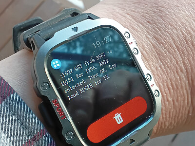

Hi Manuel, with great Respect.
I have hmm… an ugly parser looking for my /var/log/apache2/access.log
I think the field separation changed… which was ‘%20’ before, is now “+”, correct?
I’m pushing station automation towards the limits, following the rule “Each contact claimed for DXCC credit must include contemporaneous direct initiation by the operator on both sides of the contact.”
