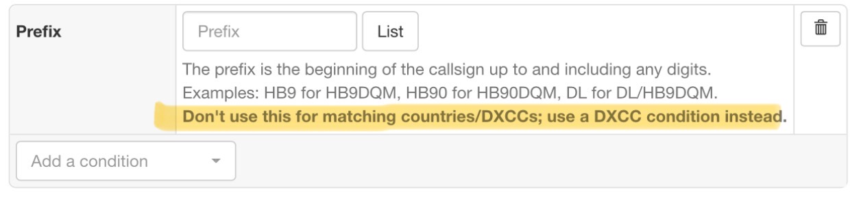

Have a look:
Also, the way you describe it, you will probably want a “Spotter continent = Europe” condition, not a regular Continent condition (which applies to the spotted station rather than the spotter).

Manuel

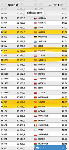

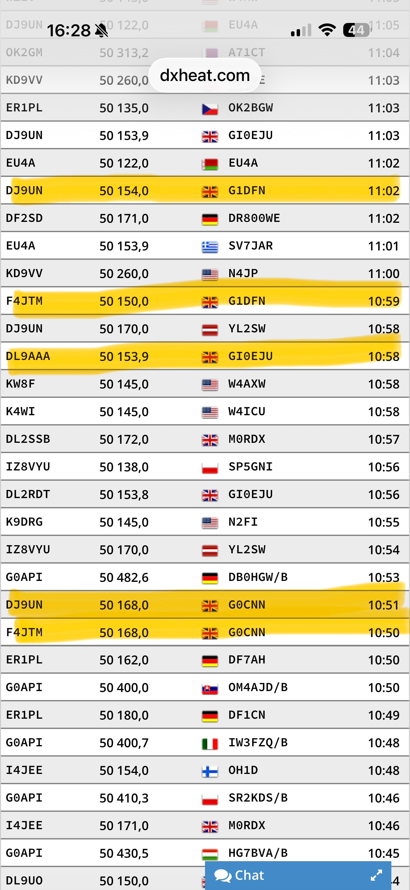

Could you please post an example/screenshot of a spot that should have triggered an alert but didn’t? Then I can check what’s wrong.
– Manuel
Hi Manuel,
Here’s some examples of 6m phone contacts on the cluster earlier. Excuse the GI, that one is Northern Ireland and wouldn’t cause a trigger.
thanks
David
The problem here is that cluster spots don’t include mode information, so HamAlert has to guess based on the frequency and spot comments. Spots between 50.000 and 50.100 are considered to be CW, while 50.200 and up are considered to be SSB. The range from 50.100 to 50.200 is considered to be unknown, unless there is some comment in the spot, e.g. “FT8”.
I’m not a 6m operator, so perhaps you have suggestions on changes to this logic based on actual practice on the bands. The band plans that I found were not entirely consistent.
