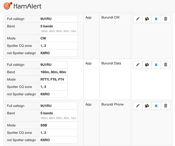

I create an entry, per mode (CW, Phone, Digital) for the specific call, for the band/s I want to know about; limiting the spotter to ‘local’ (based on which direction too, east or west of me).
This has worked well, BUT you must update the triggers after each QSO.
Why exclude a spotter call? Because he is rent a rig so his spots could be from the wrong zone causing a false alarm.
Because it is call specific; repeat as needed but you could try adding other DXpedition calls in as well, which may/not match your band mode needs.
Yes, I may have several trigger sets when there are many teams in the field. That’s where cloning the triggers takes up less time; copy/clone, adjust the trigger, save, repeat.
73 es gl,
Rick nk7i
