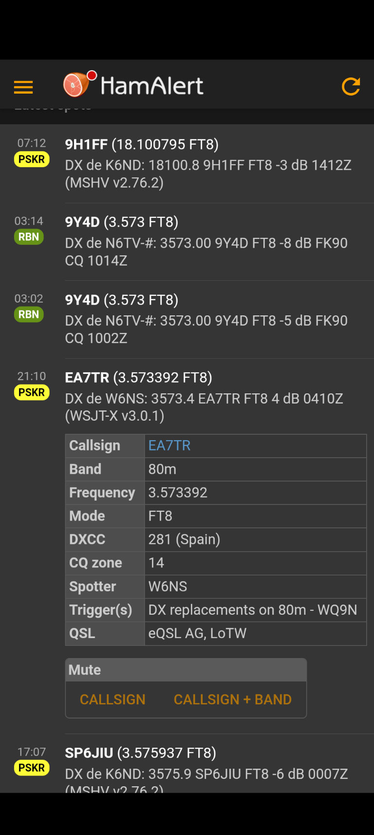

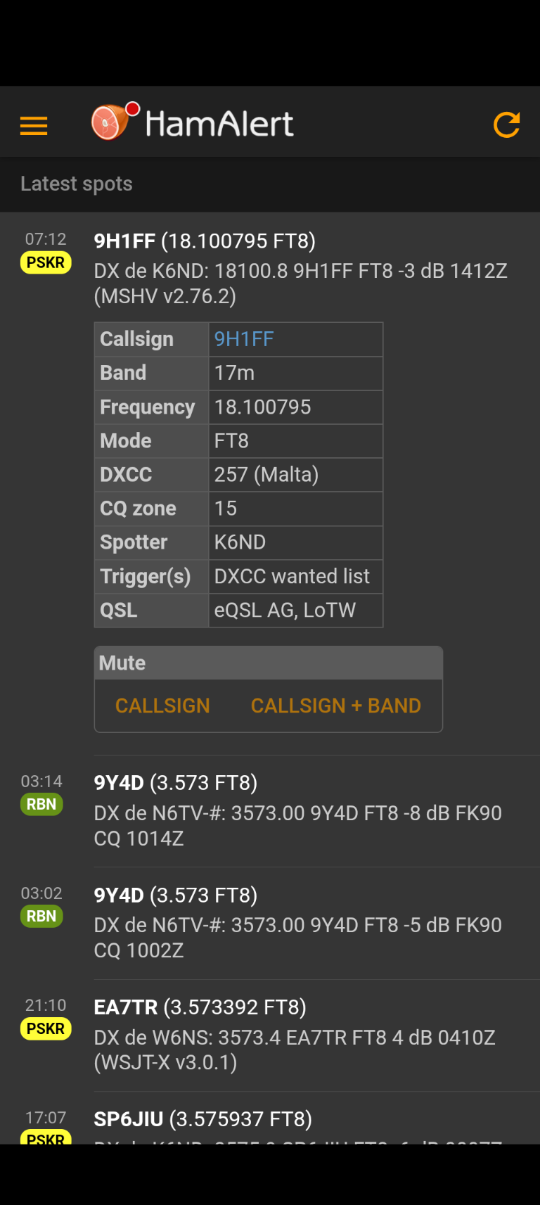

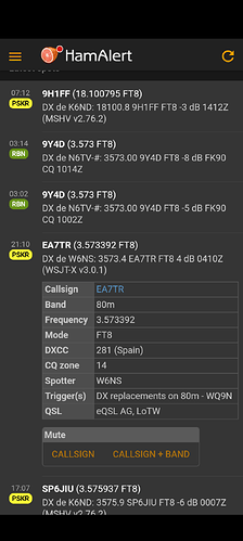

Could you post a screenshot of an errant spot, with the spot details opened, please? That would help me troubleshoot the issue.
Here are two screenshots of “non California” spotters
